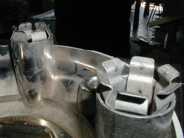

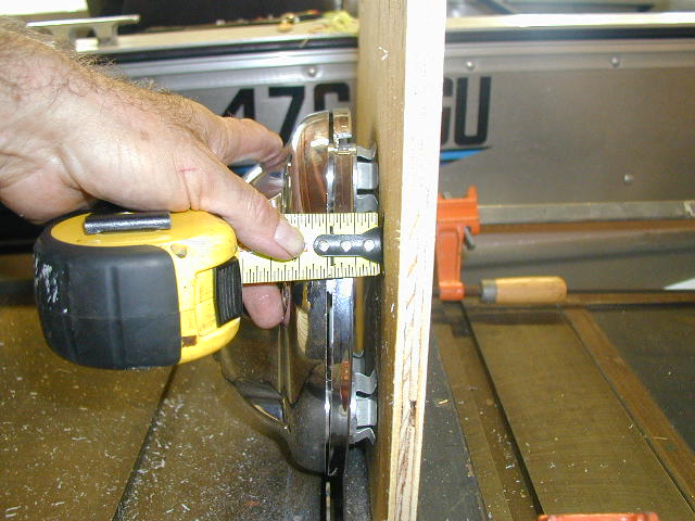

I got my wheels (only) off craig's list for 200.00 I had the centers machined out @ 4.80. This is how I trimmed the 2nd gen center caps and clips.
Attached Thumbnails H2 Wheels (Thanks DTR)-center-cap-cut-off.jpg   H2 Wheels (Thanks DTR)-lug-nut-clips1.jpg   H2 Wheels (Thanks DTR)-02.jpg

I have a short description of how I fit my 2nd gen center caps on my H2 wheels over on the TDR under my readers rigs, (Brad's Pics) but don't know how to send the link. If you have experience using a table saw it would be very easy.........just be careful! I trimmed the lug nut clips as shown in an earlier post. They fit perfect, nice and tight.... bp
