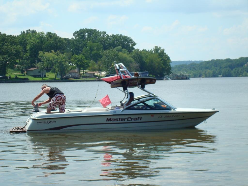

This was my first boat, bought it for $13,500 with <200hrs. Had it 6years, only added the tower and minor upgrades, like new speakers. Sold it for $13,500 with 500hrs on it.

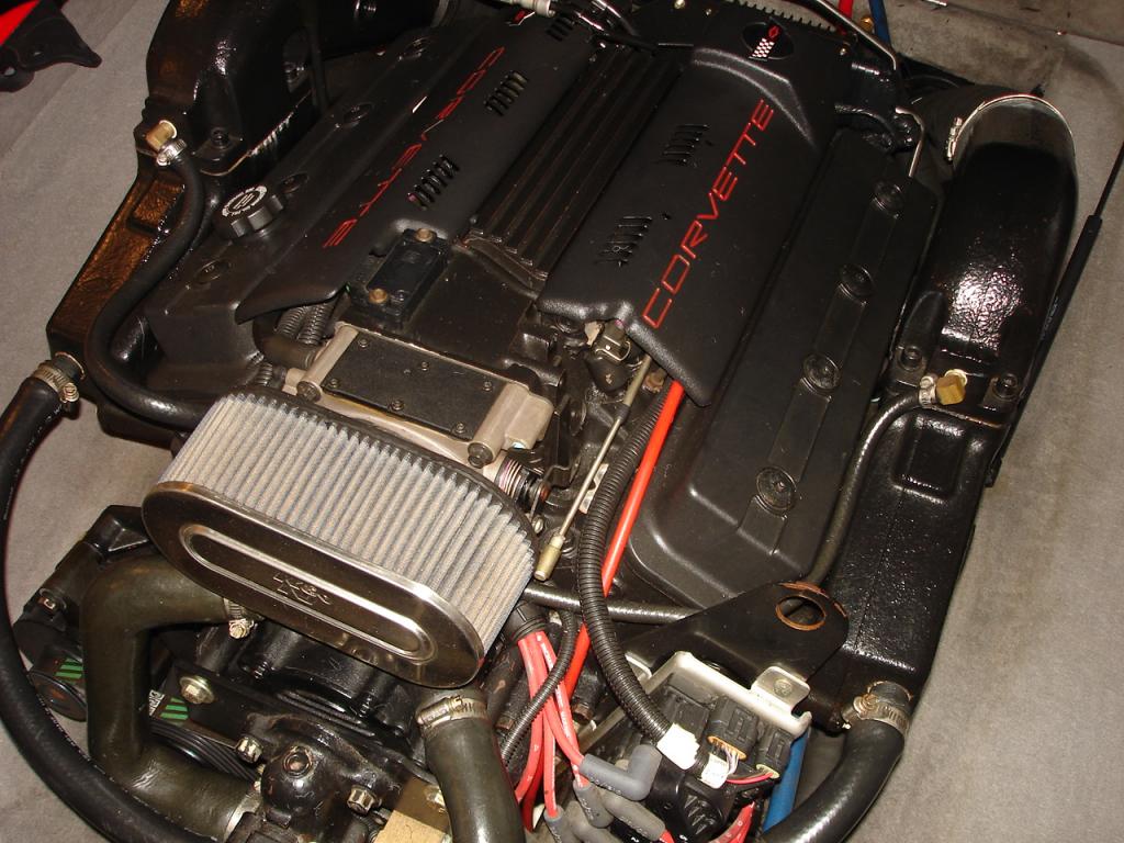

Unless you're dead set on having a 5 +/- yr old boat, take a look at older inboards. IMO, the only downside to an inboard ski boat is how it rides in rough water. Not terrible, just not like a deep vee.
The plusses far outweigh that IMO. First, no injury potential when the kids are jumping off the back of the boat all day. Nice swim deck at water level and no prop to hit. Good fuel economy. I could go out for the day, all day, boarding, skiing, some cruising and use less than 20gal of gas, with a 330hp engine! Never gonna complain it's underpowered. You live out west. Get that 3.0 on a lake at 6000' elev and propped down or not, it will struggle to get on plane even with noone in tow. Ease of maint/repair, it's a small block V8 with a simple gearbox and a prop. Most of the parts for the engine you can get at Napa. Relaibility, 2000+ hrs is the norm for a well maintained boat before any major mechanical work needed. Resale, you spend $10k on a well maintained, EFI ski boat with 1000hrs or less and you'll get most if not all of that back 5 or more years from now if you sell it. Watersports, better than any other type of boat for obvious reasons and alot of them have wakeboard towers already.
