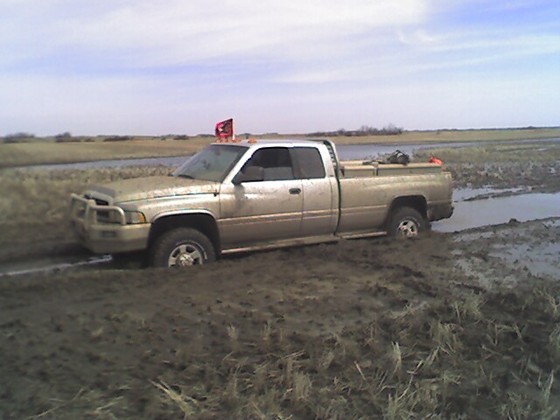

Here's why I recommended springs over air....
If I told you I saw this service every day I would be lying....but when the rains come and you gotta go, you gotta go. Add in the constant shower of flying gravel that flattens or tears off everything...
Maybe they have better lease roads in FSJ than we have down here-probably do as a lot of ours are trails out across the summerfallow.
Jason

Jason, does that ever look familiar. The mud/clay up here where I am working is so sticky and heavy that it can fill my wheelwells right up. Alot of the guys that run airbags up here always seem to have one flat one because of the mud/gravel etc. That is why I am hesitant to subject myself to it. Even a FASS would have about 30 lbs of mud stuck to it if mounted in front of rear wheel. I do like the idea of airbags but for the oilpatch mud I am not fully convinced that they are what I need.
