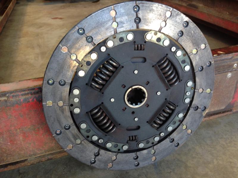

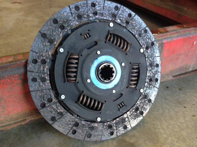

I would have loved to get 150k out my South Bend- but sadly, I got about 10% of that.
Below is what mine looked like at less than 15K miles (was pulled due to pedal vibration). I've done plenty of clutches in cars- but I let a trusted diesel tech do this work on my truck. I've never seen anything like it- smooth on one side (with hot spots even) and chewed up normally on the other. My tech said the clutch material in the bell housing was like coffee grounds. He is a diesel guy through and through- one of the best in my area.
It looks abused, but I'm the only one driving it, and my driving style didn't change with the new clutch. My stock set up with the dual mass flywheel lasted 105k miles (I've owned the truck since new- 16 miles on it when I bought it). So it's pretty hard for me to believe my driving style destroyed a clutch that should have exceeded the stock performance.

That clutch obviously got very hot and that can only be done by slipping the clutch. Funny thing is we had one of the worst winters in decades and have seen a lot of this this year but everyone keeps insisting nothing happened. Our OFE series clutch has held up well through time but obviously did not do well for you.
Peter
