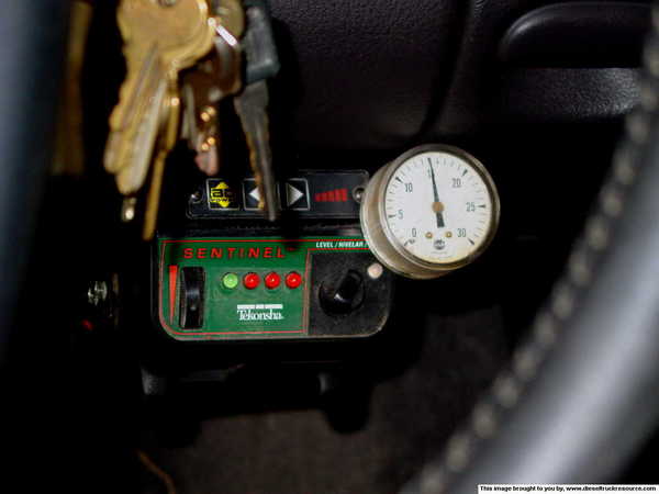

If you have an old R12 Freon install kit w/gauge, you can use it to check the lift pump fuel pressure, otherwise kits are avalable at most chain type auto parts stores.
Don't forget to close the fill valve.
Screw the connector on the fitting of the injector pump on the driver's side of the engine.
Turn the keyswitch just enough to "bump" the starter to get The Free 25 Second Lift Pump Run.
Stock spec is 10psi+, most folks look for 15psi.
I extended the gauge kit line with about 5' of greasegun line extensions, fittings and a needle valve (to dampen pump pulses so the gauge needle isn't a blur) then sealed them up with Permatex non-hardening sealer.
