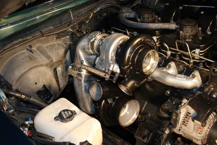

When installing the twins on my heap, I went ahead and had all the hot stuff silver-coated to keep as much heat in the exhaust gases as possible. On the flip-side, I painted all the cold-piping satin black so as to help Dump heat from there (Colors like white and silver tend to reflect heat like a mirror whereas dark colors like black tend pass heat such as is seen on a solar panel or a heat-sink on a high power stereo).

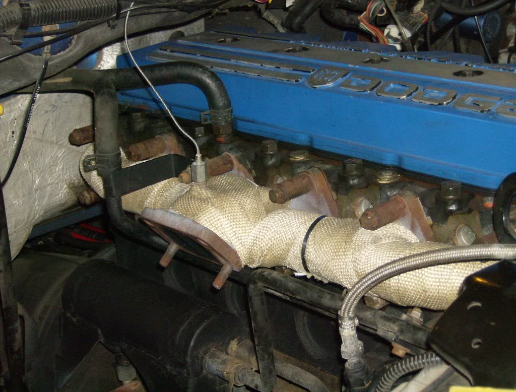

If you were to include wrapping the exhaust manifold as well perhaps you'll notice a faster spooling turbo.
The fly in the ointment is the fact that we're dealing with cast iron which is much heavier. It's gonna be slow in soaking up heat like in a drag race setting, and equally slow in releasing it. In a more realistic setting such as a work truck, I think it'd still be of benefit in the long run.
Things such as this have a much greater impact on thin-wall exhaust plumbing.
