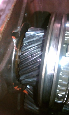

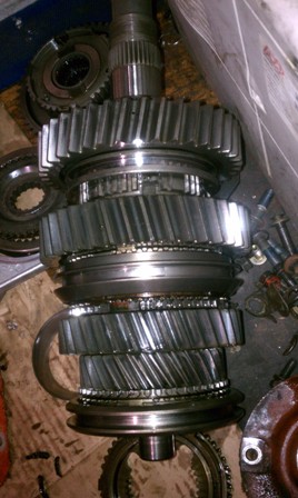

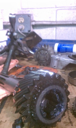

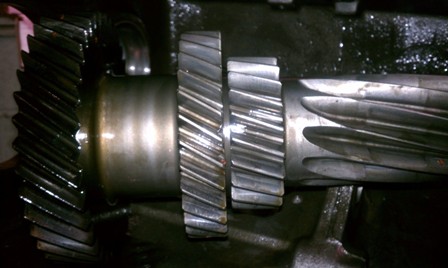

As promised pictures. Pocket bearing failed, causing the input to go a bit sideways, which in turn made for bad contact on the counter, then metal went though the whole transmission and took out 2nd and 3rd gears. 5th both driven and drive are gone too. 1-2 outer blocker ring is gone to, but not from this failure. Don't know what made the pocket bearing fail? I suppose low fluid level from my cracked tail housing? But then again maybe something small got in the oiling hole and didn't allow oil to get into the bearing. I don't think it shows in the picture but I scraped out some of the plastic cage that was supposed to house the pocket bearing, it was a molten mess in the input shaft. Oh well live and learn.
