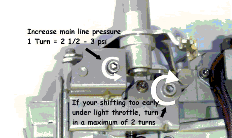

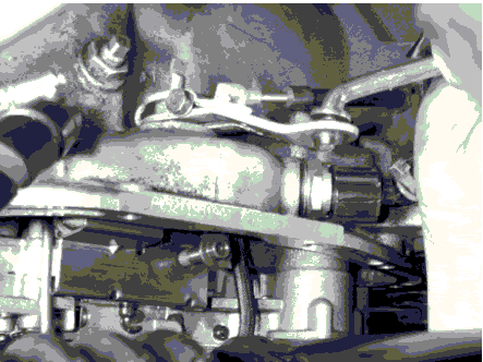

Here's some pics to help with this operation. When the VB is in place, you'll need to cut down the end of the 3/16ths allen wrench to make it work up there.
Put a pressure gauge in the main line test port on the passenger side about in the middle. This will allow you to see before and after pressures. A 0-300 is the best gauge to use, if you want to test every aspect of the trans. For just the base test, a 0-100 should be good.
First pic, is off the drivers side with the pan removed. You can't see the adjuster unless you look up at the edge of the VB.
2nd pic, is self explanatory.
Your pressure will only increase relative to throttle position. The more throttle, the more pressure, based on the kickdown cable adjustment.

for testing purposes, there's no risk. Would I drive it that way for a long period, no. The VB mods work with the clutch setup, to coordinate perfect shift timing.
Sorry about the crappy snap32 converstion pics, gif's don't look to clean, but they're small in size.

Tryed this adjustment today and it made the problem worse. Adjusted line pressure a full turn CW. Now it wants to drive around in 2nd gear almost everywhere, lol. Gonna try and pull the pan tonight and go CCW 2.5 turns and see if that helps.
Maybe the Suncoast VB was making too much pressure for the trans to shift out of second?

so you get 1-2, and nothing else?
if you turned the pressure screw CW, you dropped the pressure 3 psi.
You change the blue loctite adjuster for kickdown? it sure seems like you're getting too much throttle pressure now. Will it drop into 3rd if you run up the rpm, and let off the throttle?
