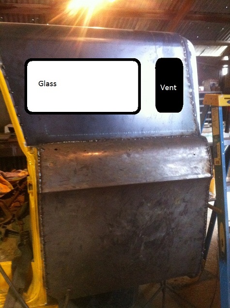

I've been working on my old power wagon making it an extended cab so I'm not cramped up. When I drive my work truck with the window down and the sliding back window cracked open it makes for a pleasurable to drive with the drivers side window down. If the back window is closed the wind dry's my eyes out real quick.
Since they don't make a sliding back window for this truck I was thinking of installing one of these vents. Figured if I installed the vent behind the extended cab window the air would come in the vent and out the drivers side window. Making it nice to drive with the window down.
You all think my thinking is correct on the extra vent? Will it help keep the wind from coming in the drivers side window?

sweet build! i would think that if you could find a window out of a minivan or some kind of van that has one of those pop out windows and get the fram and graphed it in that location you alread have then you wouldn't even have to bother w/ adding the vent maybe? and you've have access to glass that's pretty much readily available instead of a custom piece saving time and money on the install.
