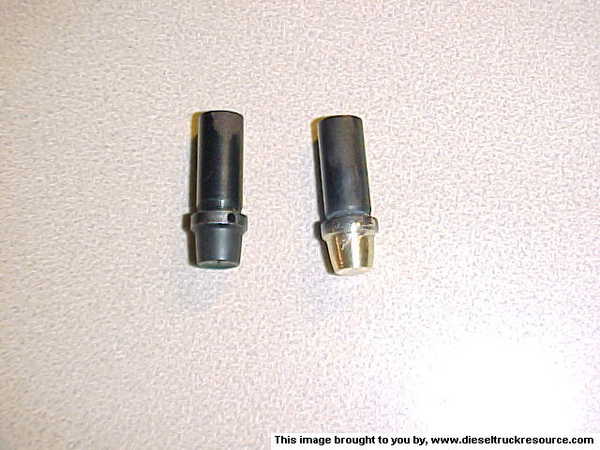

My truck ate another plunger last night. It was a modified one too.
Has anyone tried replacing the rubber with a brass tip? Any reason I should not do something like this?
I made one last night and I'm going to try it tonight when I get home, maybe it'll work maybe it won't we'll find out.
Pic's are awaiting approval.

I dont know, but let us know. I have been pondering a similar idea for a long time now, like a nitrile plunger...brass should work though???

So do I, but so far, no good. It shut the truck down when it was cold, but after I got it hot it wouldn't shut it down. I'm going to try a different shape and see what happens.
Maybe more a needle point will work.

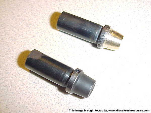

Update:
I modified the the nose so that it has an angle that seats on the pump head. It doesn't work everytime, but the more I shut it down the better it gets. Some times I have to turn the key back to run then off again to shut it down.
I'll check it a week or so and if it doesn't look good I'm going to a cable.

Mike, how did you go about adding/attaching the brass?
Brazing?
Old 10-18-2007 | 10:09 PM
  #12
JD730's Avatar
Joined: May 2005
Posts: 2,510
Likes: 1
From: Belvidere, NJ
Brazing?
Yes, silver braze (or silver solder to some) to be exact.
