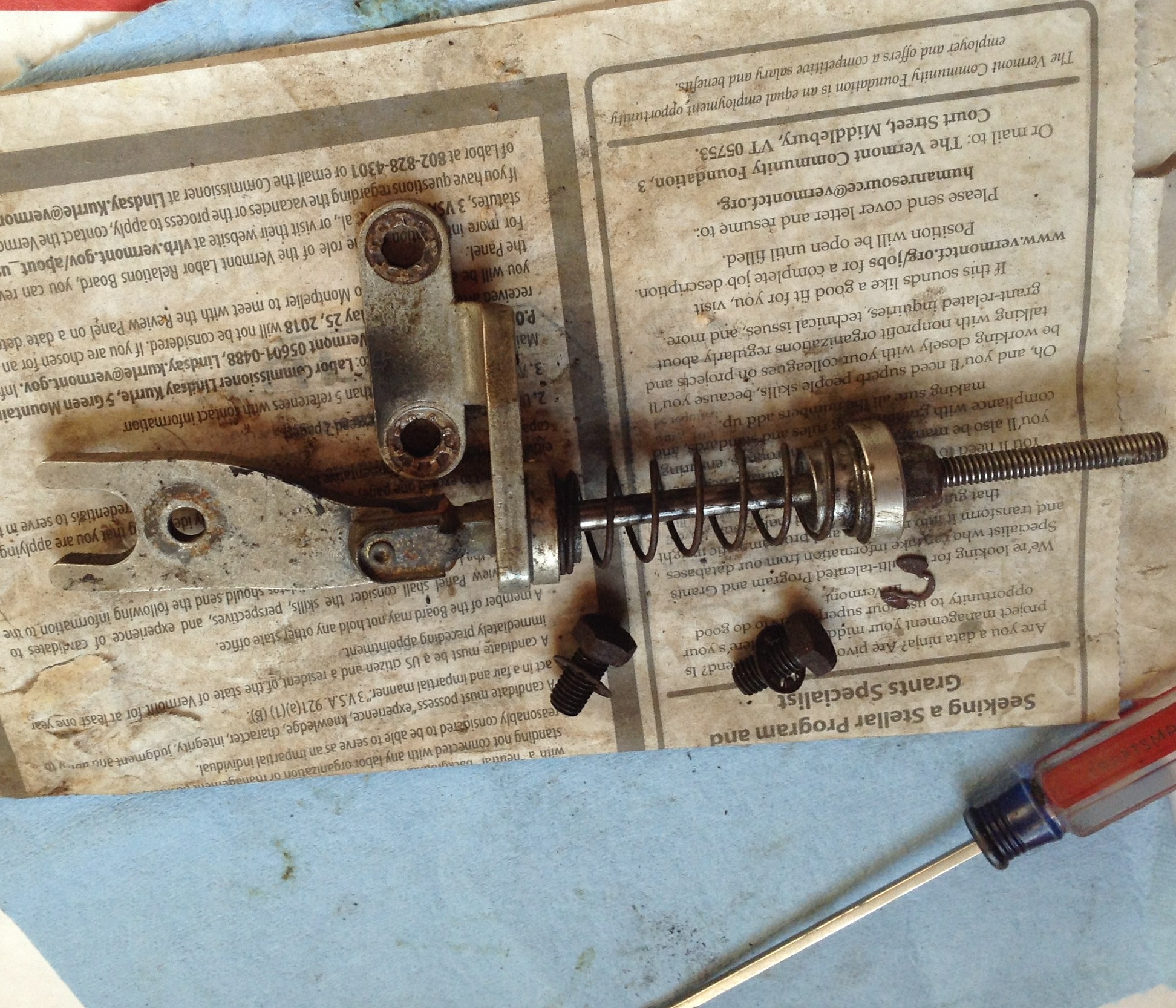

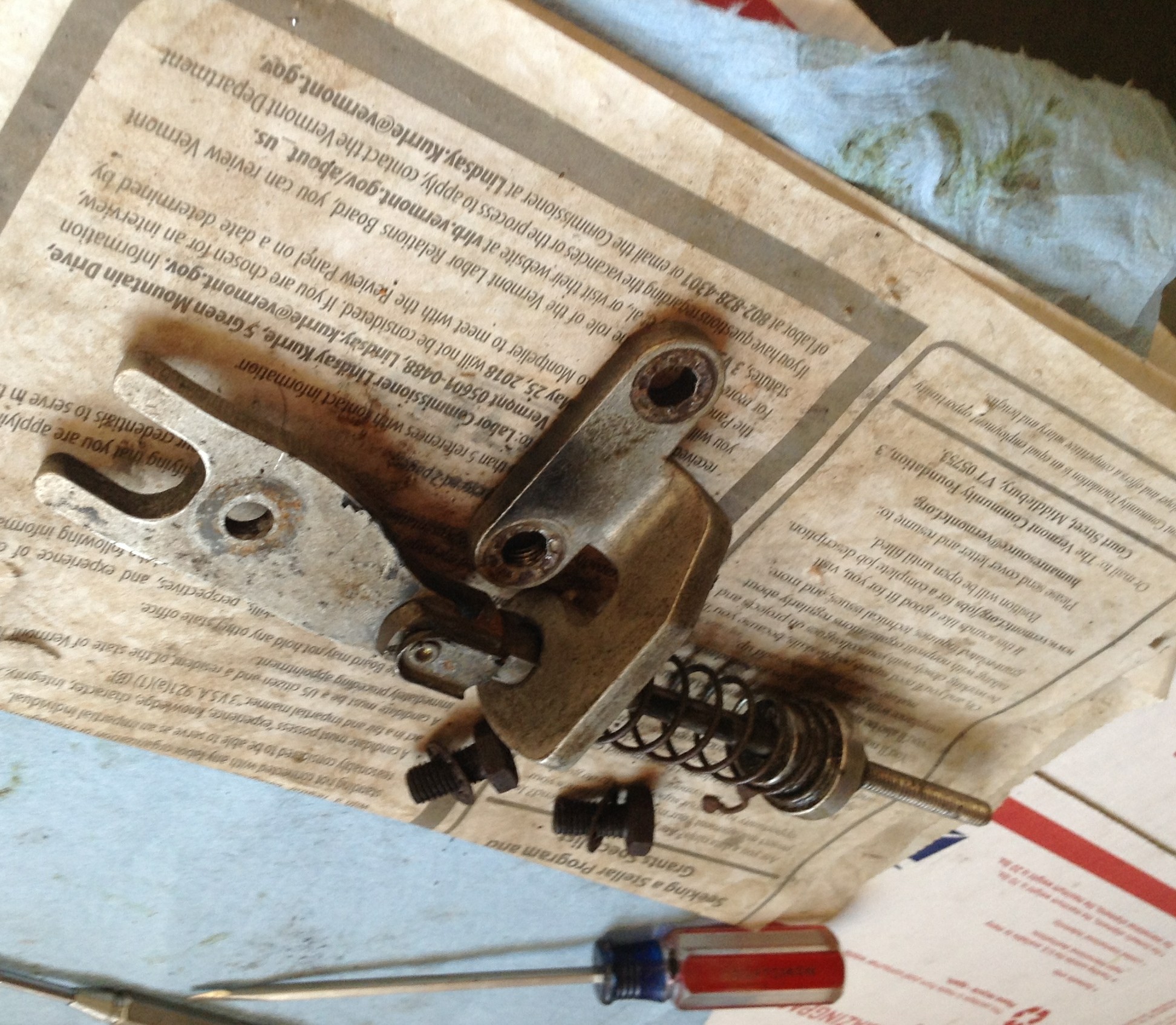

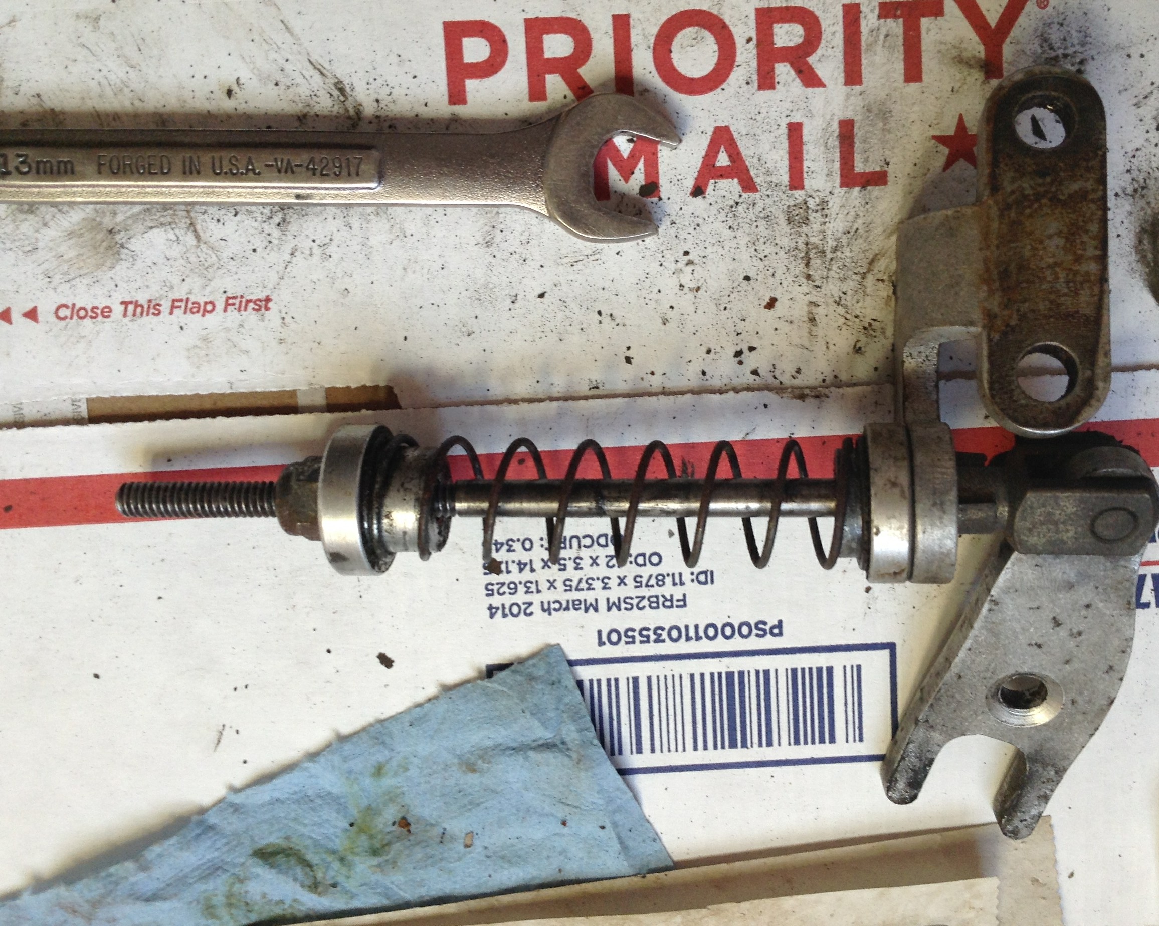

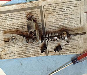

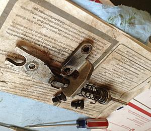

I thought you guys might like a look at the spring gate assembly I found to use.
From the research I have done on the web, it seems like an old BD set up.
I am liking the ease of adjustability of it.
The RC past state inspection yesterday with flying colors.
I took it to different local shop it had never been too, so it stopped all work in the shop for a while as the three shop techs and the owners checked it out. Rust free old sheetmetal [and clean Cummins conversions] blows people's minds out here.

Sorry it is upside down,but every time you send me a photo, it comes in upside down.
I tried a bunch of different ways to correct it, but it had no effect.
Maybe hold your iPad differently the next time you shoot something

T-Man, Ollie Here ya go
not so sure this was upside down
I use microsoft picture manager

Upside down on those three pictures was not very confusing. I mostly just wanted to show you guys what I found that worked well for me.
I saw several "home built" spring gate sets up on youtube or the like.
This looked clean with its aluminum brackets and such, but I had my doubts that the little spring would have the mustard to get the job done. The longer lever arm for the turbo flapper makes the light duty spring perfect.
I thought with a few pictures, guys like Mknittle could make one of these on there kitchen table on a rainy day.
