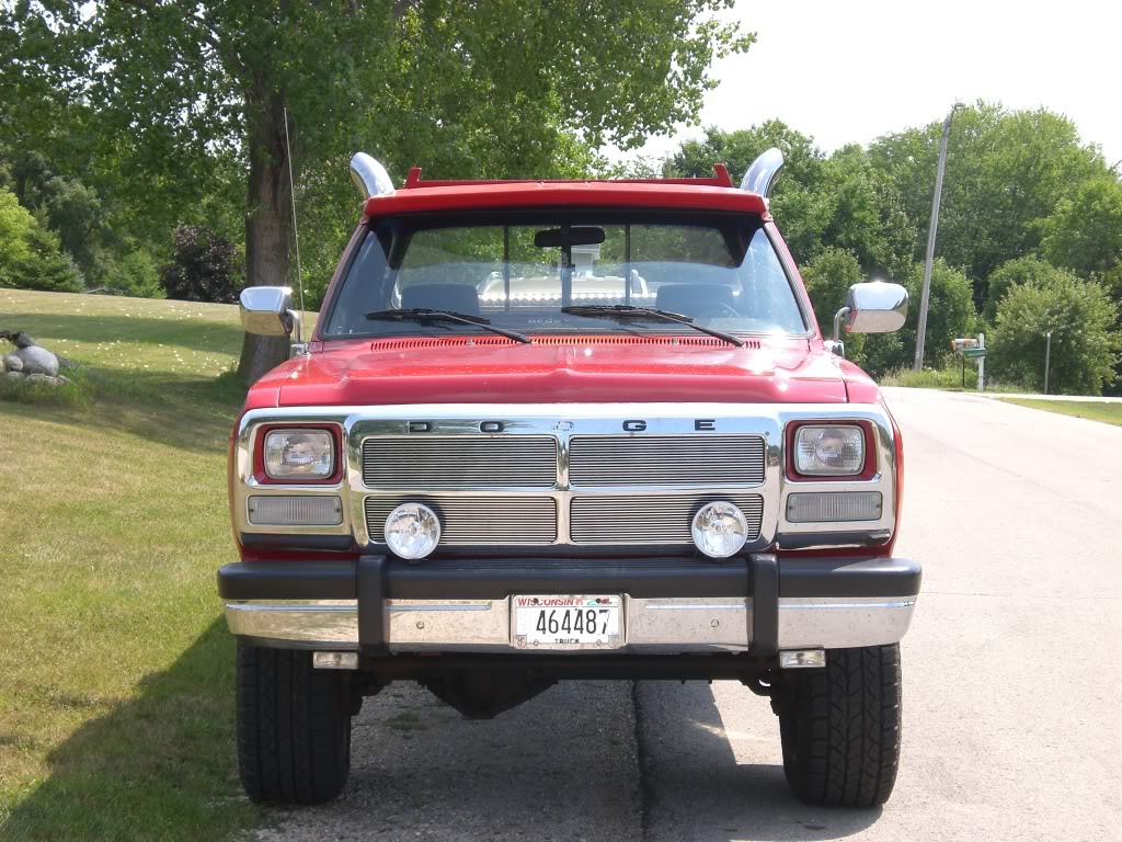

Here are the rims on my truck with the stock 265/70R17 BFG Rugged Trails.

Here's my truck with a set of 315/70R17 Yokohama Geolandar AT/S tires. I would recommend this tire to anyone who drives in the winter, but I would be careful putting a tire of this size onto a truck without a lift kit. (34.6" tall, 12.5" at widest point, ~10.5" tread width) The wheel well openings are big enough that they look like they would fit, but when you turn you may run into problems. My springs are junk, so I made front shackles that are 2" longer to gain about 1" of height. They rub on my aluminum mud flaps when i turn, but I don't think they would rub if I took the mud flaps off. I like the protection from rocks and debris however, so I deal with the sound of them rubbing when i turn. Not a big deal. I had no rubbing issues with the 265/70R17s though, even with running boards. I do love how they look though.

Where did you get the clear marker lights on the fenders??? in the newest pics.
And dumb question, but you did use spacers on all 4 right ??
new background on my computer
Thanks guys, and yes I used spacers on all four corners. The back had no clearance issues, but I wanted the track width to be the same. It would have looked funny too. I got the clear marker lights from ebay.
